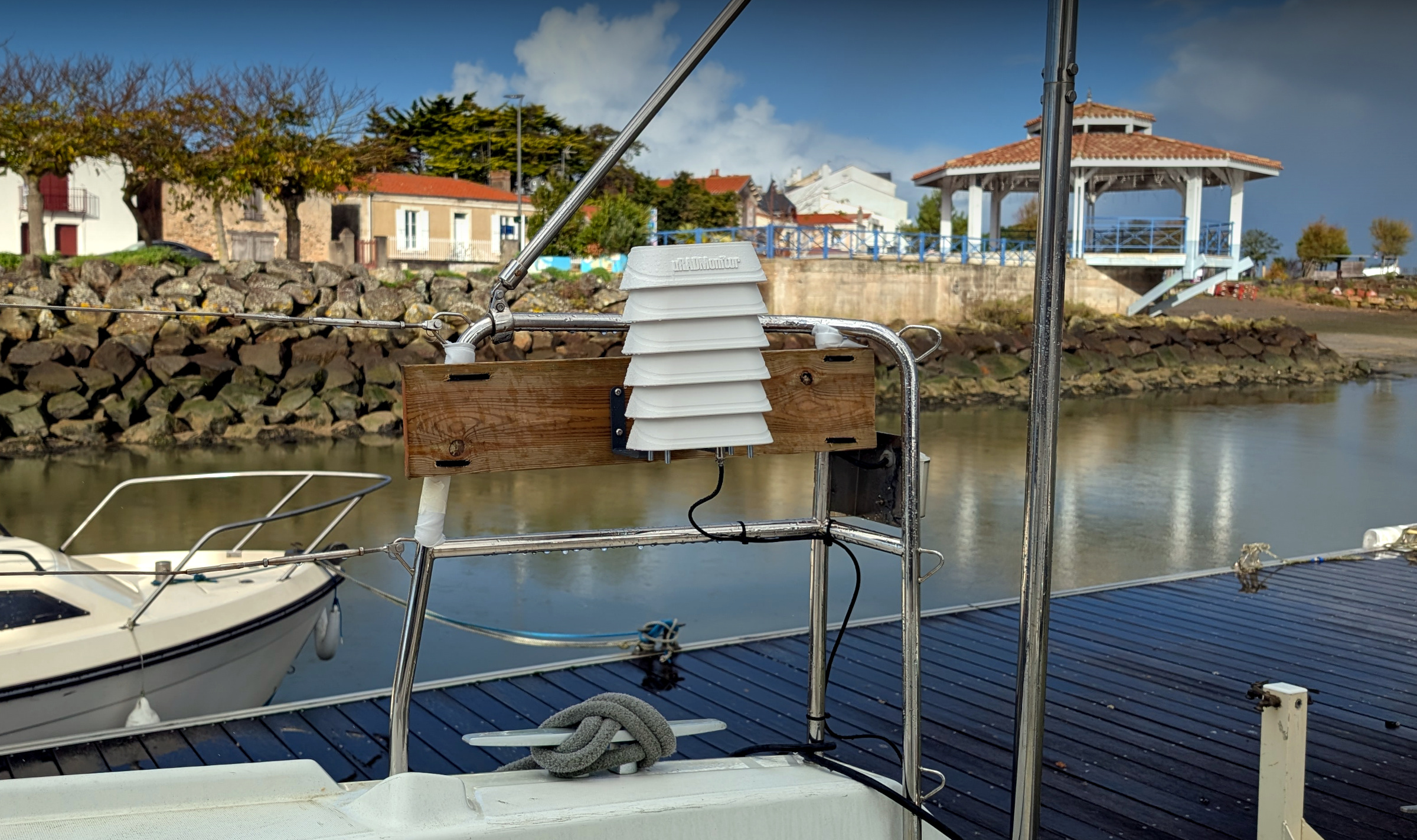

The MODEL CITY in its radiation-shield housing, mounted on a hardwood plate lashed to the stern rail. The louvred shield protects the electrochemical and particulate sensors from spray and direct sun while letting ambient air circulate freely.

The installation: Mounting a land sensor on a sailboat
The MODEL CITY is designed to be robust, but the sea asks a specific question the rooftop never does: salt. The electronics are fully protected against rain but salt spray is more aggressive, and the practical advice for a marine install is to get the unit as high and as clear of the water as possible, ideally up the mast. On this test boat it sits on the stern rail, in vertical orientation as specified, with the louvred shield facing down to shed water. Power was the easy part. The CITY accepts anything from 6 V to 60 V DC, so a boat’s 12 V system drives it directly with no converter and for vessels with unusual electrical setups, a custom variant can take up to 100 V. Here it draws from the boat’s house bank, which is itself topped up by a wind-and-solar charge controller: a genuinely autonomous, off-grid sensor node bobbing in a harbour.

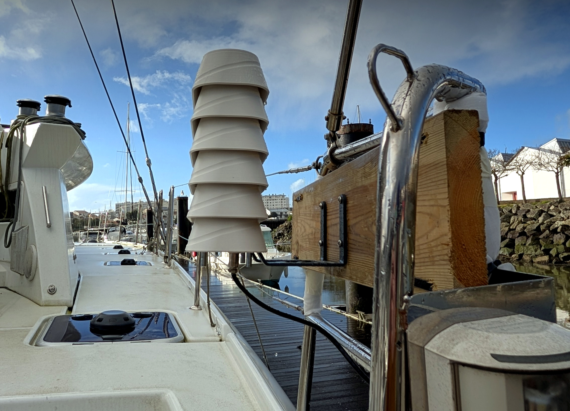

CITY’s radiation shield seen along the side dec
Marine install checklist for a MODEL CITY: mount as high and as far from spray as practical (mast preferred); keep it vertical with the shield venting downward; power from the 12 V house bank (6–60 V DC accepted); secure the cable run against wind and chafe.

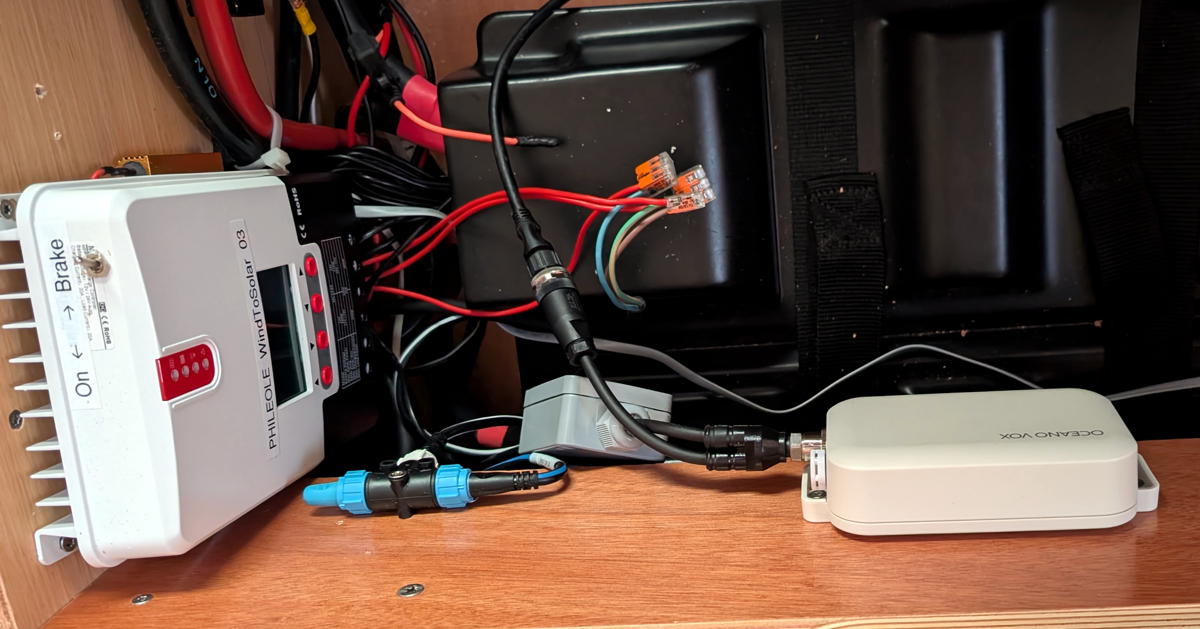

The integration: Talking to the VOX box over a wire
The interesting engineering is in how the two devices talk to each other. OceanoVox had a clear requirement: the system must work completely offline. No internet, no remote server, no dependence on anyone’s cloud to interpret the data. The VOX gateway needed to read the CITY’s measurements locally, on the boat, and place them on the NMEA bus itself.
The MODEL CITY supports exactly this. Alongside its normal network connectivity, the unit exposes its readings over a serial UART interface , a direct, wired data link. We used this with drones in the past. Now the CITY streams its measurement frames out on the serial line; the VOX box reads them on the boat, decodes the payload with its own firmware, and forwards the values onto the vessel’s NMEA 2000 network. From there they join the wind, pressure and position data already flowing to the OceanoVox network over GSM or satellite. No server sits in the loop. The decoding happens locally, on hardware, exactly as required , which for a vessel that may spend days out of mobile range is a necessity.
Below deck: the OCEANO VOX gateway (right) wired in beside a PHILEOLE wind-and-solar charge controller. The CITY’s serial output feeds the VOX box, which decodes the frames locally and publishes them to the boat’s NMEA bus.

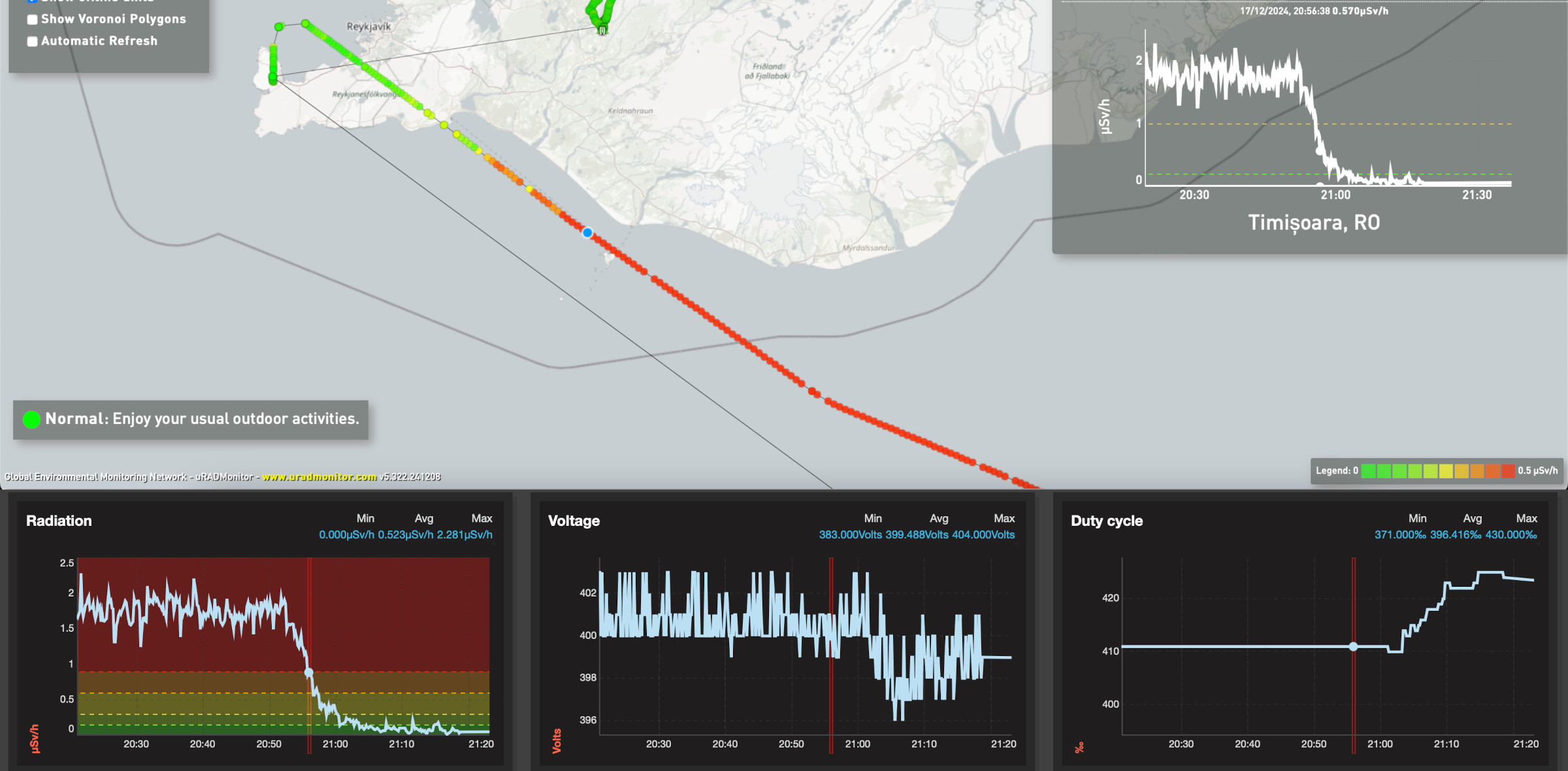

A fixed uRADMonitor station is a point on a map. A CITY on a hull is a moving pen. Read more about the uRADMonitor mobile sensors here. As the boat sails the coast, it draws a continuous track of air quality readings across water that no fixed network covers and it feeds them into an ocean-observation effort explicitly built to fill exactly those gaps.
uRADMonitor MODEL D mobile sensor tracking increasing cosmic radiation levels with altitude, in an airplane over the coast of Iceland, December 2024
