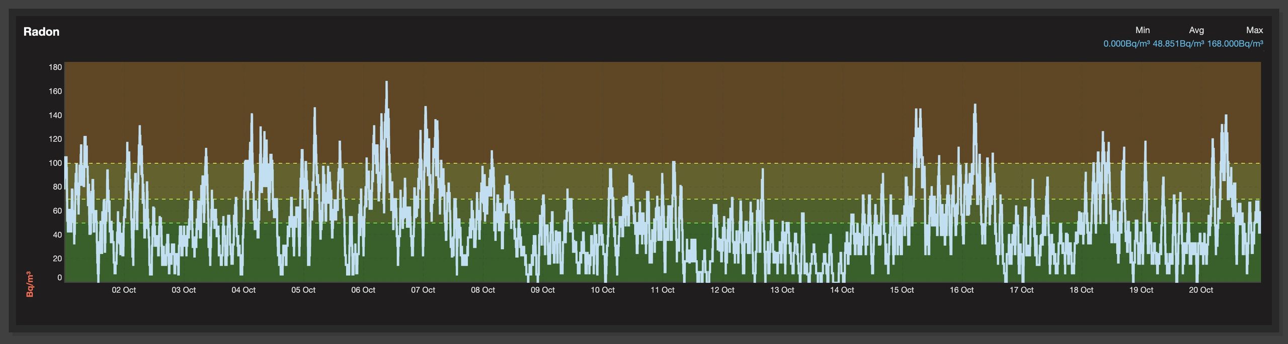

These are annual averages. A single high hour does not mean the home is above the reference level, and a single low day does not mean it is below.
Why radon changes so much
  • Day and night: radon is often higher at night and early in the morning, when windows are closed and the house is warmer than the ground outside.
  • Seasons: levels are usually higher in winter, when heating draws air from the soil into the building.
  • Floor: basements and ground floors have the highest values. Upper floors are usually lower.
  • Weather: wind, pressure changes and rain affect how much gas comes out of the soil.
Radon concentration over one week in a home
