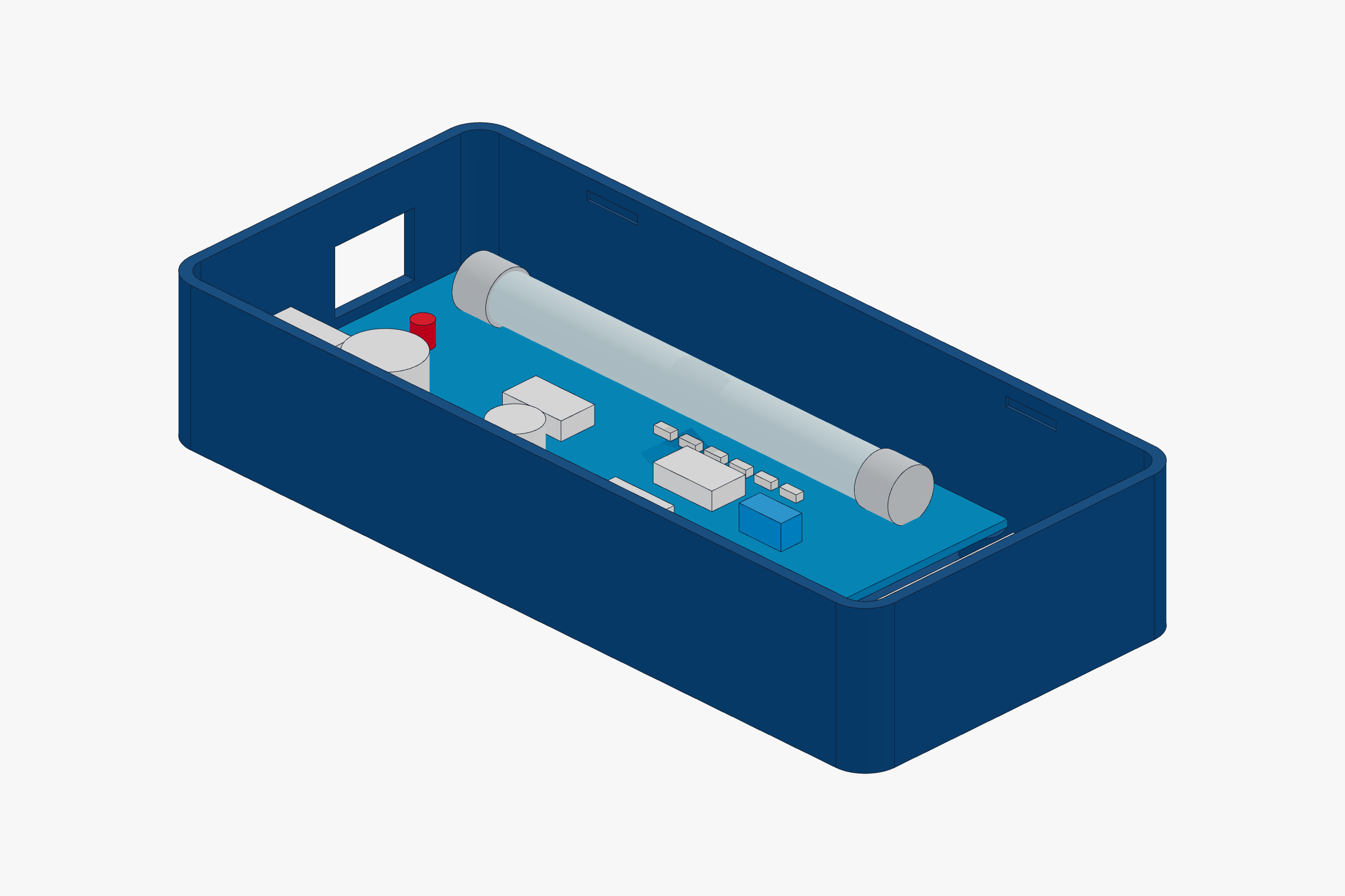

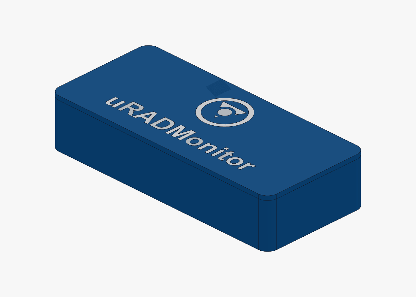

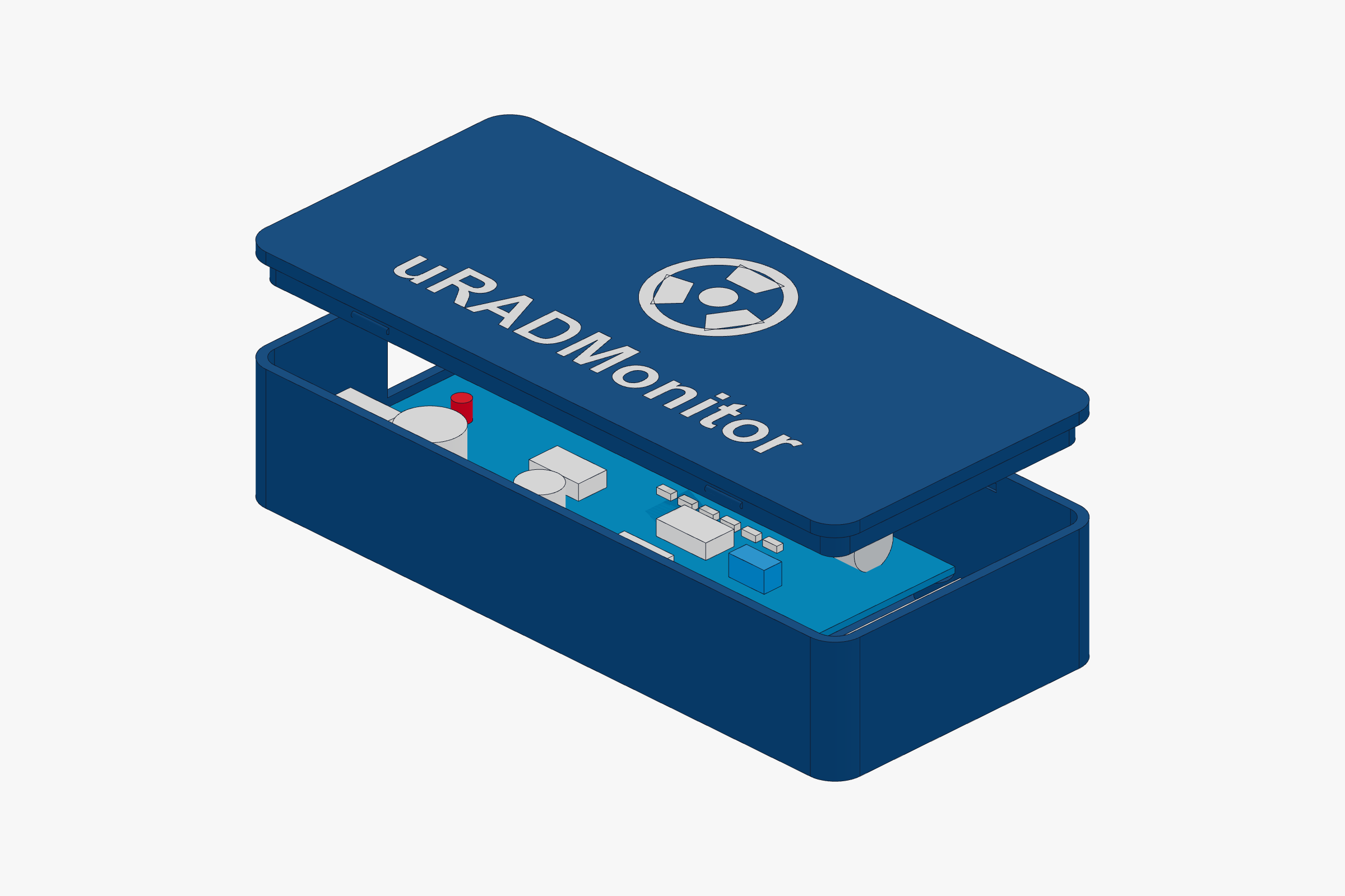

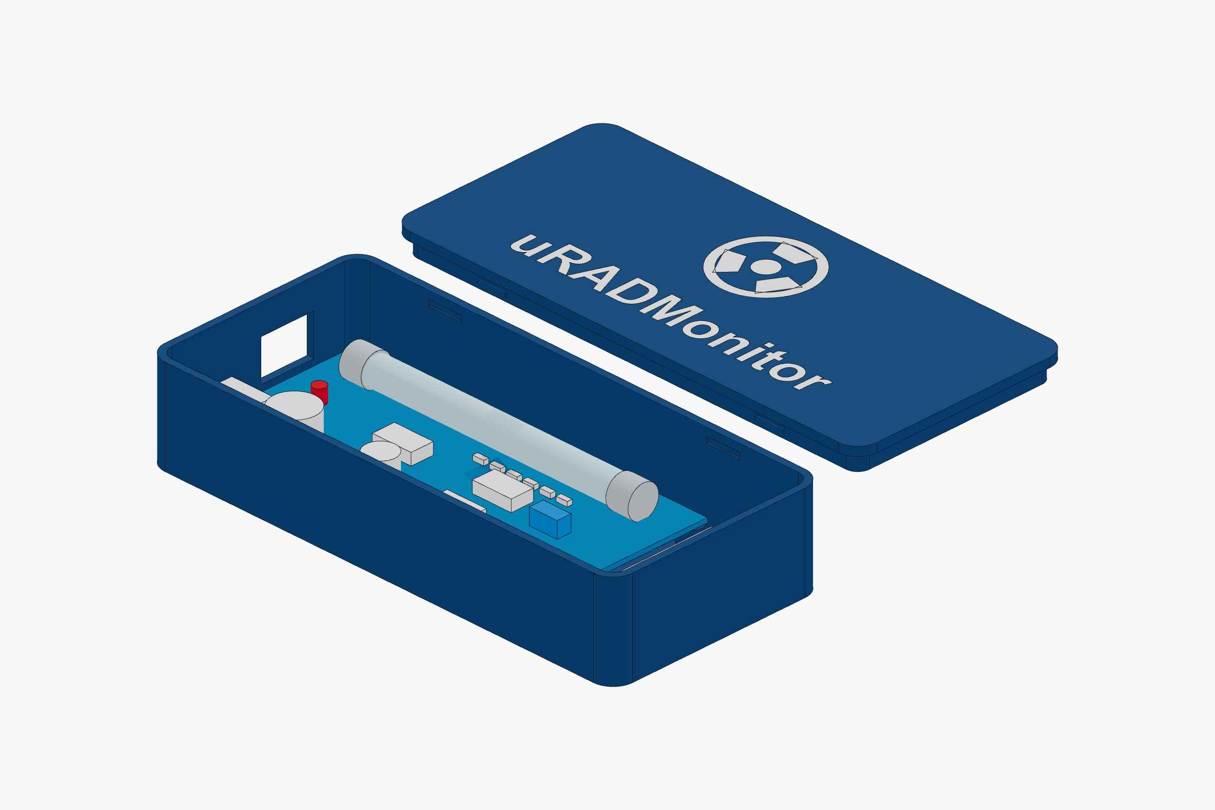

Printable enclosure

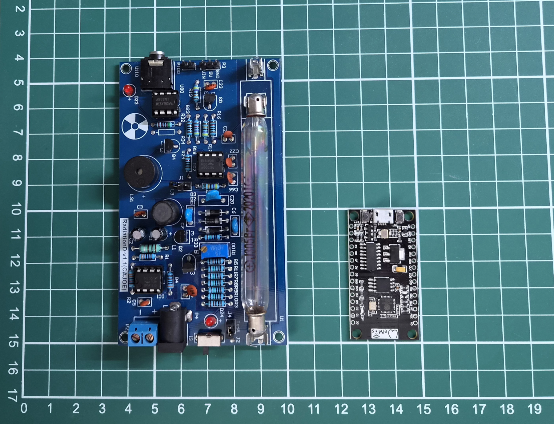

A compact snap-fit enclosure was designed around the measured mounting points of the Geiger board and ESP8266. The illustrations below use simplified dimensional PCB models to show the intended fit; the hardware photograph above shows the actual boards.

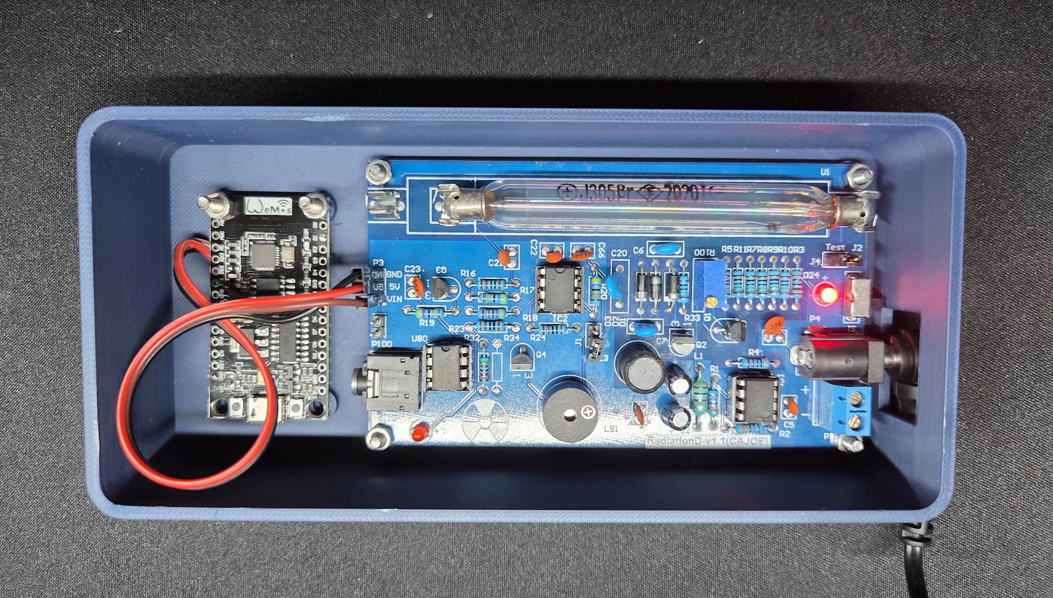

Update: the enclosure design has already gone through several revisions. This photo shows the current printed concept. The next revision will use improved snap-in PCB mounting for both boards.
