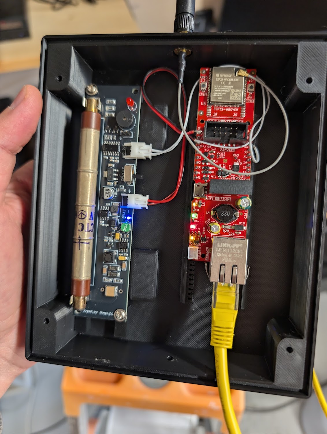

This is a write-up of my open-data station: an SBM-20 in a GGreg20_V3 front end, an Olimex ESP32-POE-ISO-EA-IND doing the counting, and Home Assistant doing the uploading. Device ID 13000200, currently in Estonia.

The hardware
| Part | Why |
| SBM-20 Geiger tube | The classic. Good gamma sensitivity, cheap, ~108 mm of active length, and the network already has plenty of them, which makes my readings comparable to my neighbours’ |
| GGreg20_V3 by IoT-devices (Kyiv) | 400 V HV converter and pulse shaper on one board |
| Olimex ESP32-POE-ISO-EA-IND | ESP32 + Ethernet + 802.3af PoE, external antenna, industrial temperature grade |
| 3D-printed enclosure | Currently indoors; see the honest status section below |

Wiring
The GGreg20_V3 has two 2-pin JST-XH connectors, and the kit with cables includes leads for both, so there is no soldering at all.
GGreg20_V3 BAT + -> ESP32-POE-ISO 5V
GGreg20_V3 BAT − -> ESP32-POE-ISO GND
GGreg20_V3 OUT -> ESP32-POE-ISO GPIO35
GGreg20_V3 GND -> ESP32-POE-ISO GNDFour wires, two of which are ground. The two connectors are independent, so both grounds go to the board — that is normal, not a mistake. You can see all four in the photo above, crossing the gap between the boards.
Pick your GPIO carefully. This is not obvious and it is easy to get wrong:
- GPIO36 and GPIO39 (SENSOR_VP / SENSOR_VN) look attractive because they are input-only, but the ESP32 has a documented erratum where ADC1 or Hall sensor activity produces spurious transitions on them. For a pulse counter that means phantom counts. Avoid.
- GPIO12 is the MTDI strapping pin and must be low at boot. On the Olimex board it drives PHY power anyway.
- GPIO35 is input-only, carries no strapping function, and is not affected by that erratum. That is what I used.
- On the Olimex boards, check the pinout for your revision — GPIO15/2/14/5 are multiplexed with SPI and the SD card slot, GPIO13/16 with I²C on the UEXT header.
One thing to check on your own board: GPIO34–39 have no internal pull-ups or pull-downs at all, so if the pulse line needs one, it has to come from somewhere else. IoT-devices specify the GGreg20_V3 output at 3.3 V HIGH / ~0.7 V LOW and state in their own example that the module provides the pull-up on its side, which is why pullup: false is correct here and why an input-only pin works. If your counts are absent or erratic on a GPIO34–39 pin, put a 4.7–10 kΩ resistor from the pulse line to 3.3 V before you go looking for anything more exotic.
And pull the J1 jumper to disable the buzzer. Inside a sealed enclosure it is useless and it draws current.

Honest status
The station currently lives in the 3D-printed enclosure you see above, next to a window. It is not outside yet.
I know what is missing — a Stevenson shield for the tube, a properly sealed box for the electronics, a desiccant pack, a drip loop on the cable — and I have the parts. But I would rather publish a station that is running and honestly indoors than imply a weatherproof installation I have not finished. A tube behind glass reads a little low on the cosmic component and is blind to whatever the window blocks, so treat my numbers as a prototype’s.
The printed shell is a compromise I will revisit too. Right now the tube shares a box with the electronics, which is convenient and keeps the pulse run short, but the plan is to move the SBM-20 out into a louvered radiation shield and leave only the boards in the sealed enclosure. The tube needs air and shade; the electronics need neither.
Next steps: north wall, PoE up to it, Ethernet surge protection at the entry point. I will follow up when it is done.
