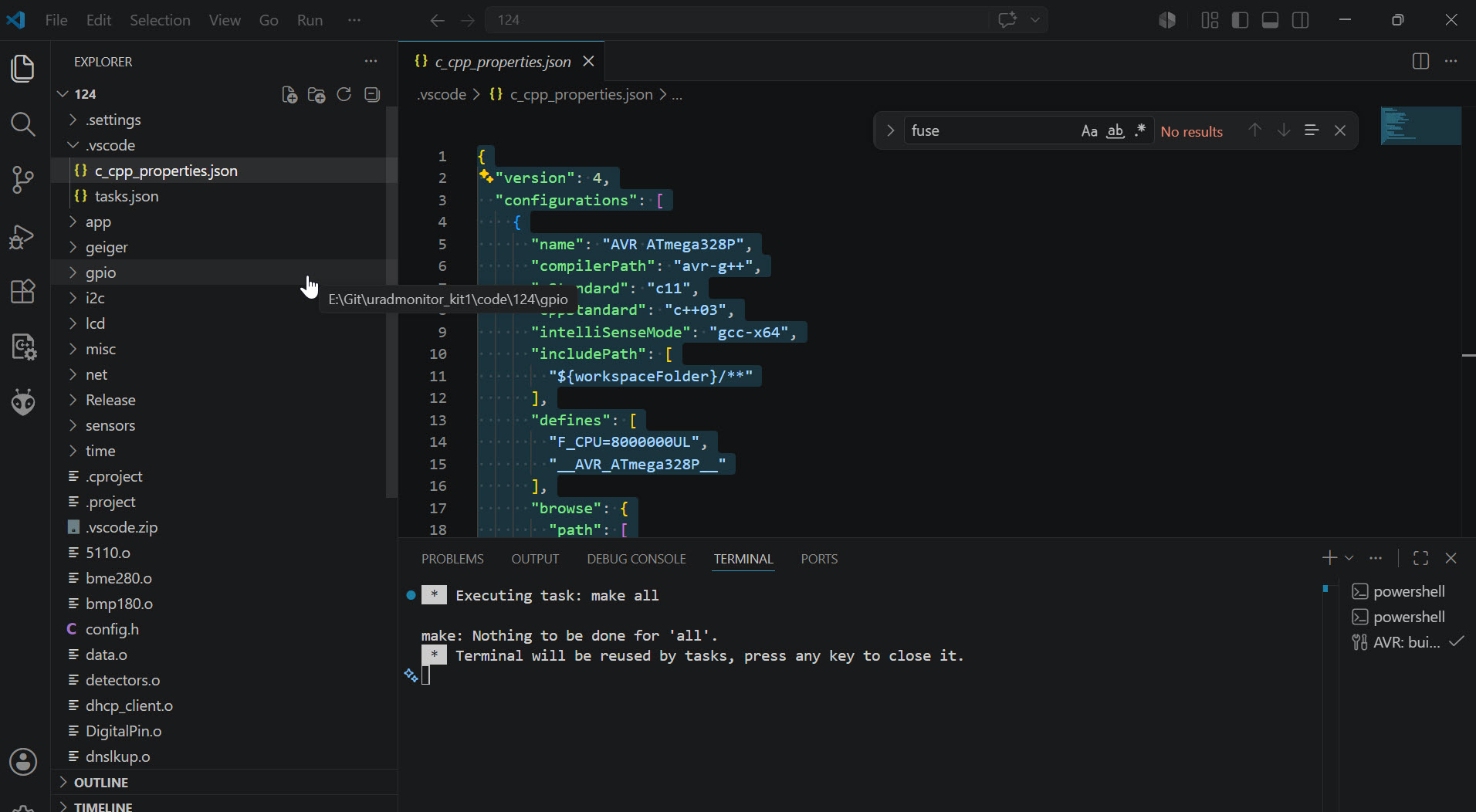

A minimal c_cpp_properties.json file can look like this:
“version”: 4,
“configurations”: [
“name”: “AVR ATmega328P”,
“compilerPath”: “avr-g++”,
“cStandard”: “c11”,
“cppStandard”: “c++03”,
“intelliSenseMode”: “gcc-x64”,
“includePath”: [
“${workspaceFolder}/**”
“defines”: [
“F_CPU=8000000UL”,
“__AVR_ATmega328P__”
“browse”: {
“path”: [
“${workspaceFolder}”
“limitSymbolsToIncludedHeaders”: true
If the Windows PATH variable is not configured, the task can instead call make.exe directly:"command": "C:\\msys64\\usr\\bin\\make.exe"
However, adding the MSYS2 folders to PATH is cleaner because it also helps VS Code find the AVR tools.
Build from VS Code
In VS Code, open this folder:
code/124
Then run:
Terminal > Run Build Task
(If prompted) Select:
AVR: build uRADMonitor 124

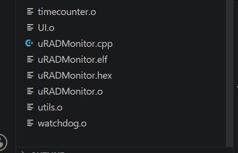

The build should generate these files in the code/124 directory:
uRADMonitor.elf
uRADMonitor.hex
The important firmware output file is:
uRADMonitor.hex
That is the file to flash to the ATmega328P.
Keep your eye on the problems tab in Visual Studio, you should only see things pop up there. If successful, you will see a message in the terminal saying “Terminal will be reused by tasks…” and those two files mentioned above will be in your code/124 directory.
