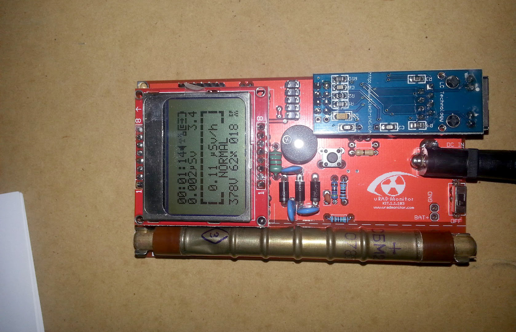

Hi Radu,
Here is the screen as well as the web output.
The browser screen capture was taken a couple of mins after the physical screen.
Thanks,

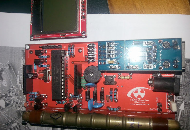

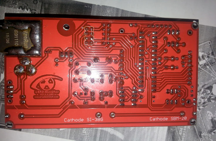

MoranParticipantI have soldered mine the case is waiting for me to have time to complete some upgrades to my 3d printer
There is an issue connecting to the network it doesen’t appear to be picking up an IP address.
I logged into the router the uRadmonitor is listed in DHCP table as expired.
The monitor is happily working in offline mode but I would rather resolve the issue so it can be mounted in a better location.Here is a photo with the LCD removed
Back of board I have not cleaned the flux off yet:
I also have a BM280 module should I directly plug this in the header or run a cable and locate away from board?Also note I had to replace the switch it was a bit dodgy and bumping board would cause power to switch off. The jumper is fine as this will ultimately be powered on most of the time 🙂
