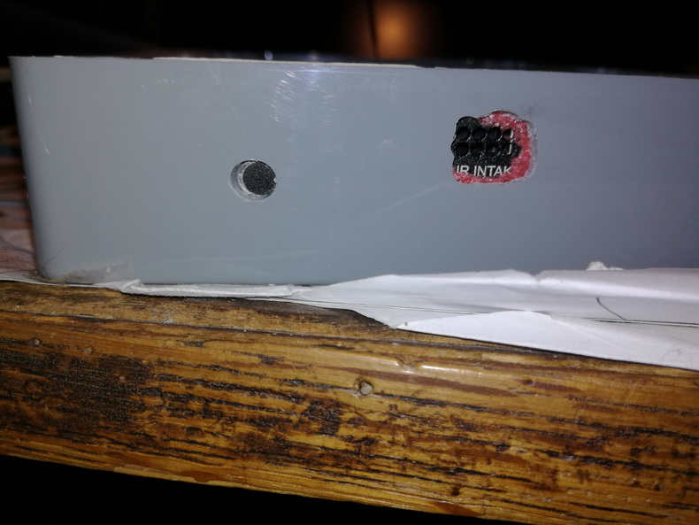

ON1GLParticipantmanaged to get the mic at the outside of the plastic box, but the results are disappointing 🙁
Noise level without mic connected are around 47 dBA, much to high, is there something wrong with the amplifier circuit or is that software ?
Included are a few pic of the modification.Attachments:

Inside the metal housing and inside a plastic weatherproof housing will dampen the noise perhaps to much, will try to move the mic to a hole at the bottom of the outside plastic housing.ON1GLParticipantNoise sensor,
