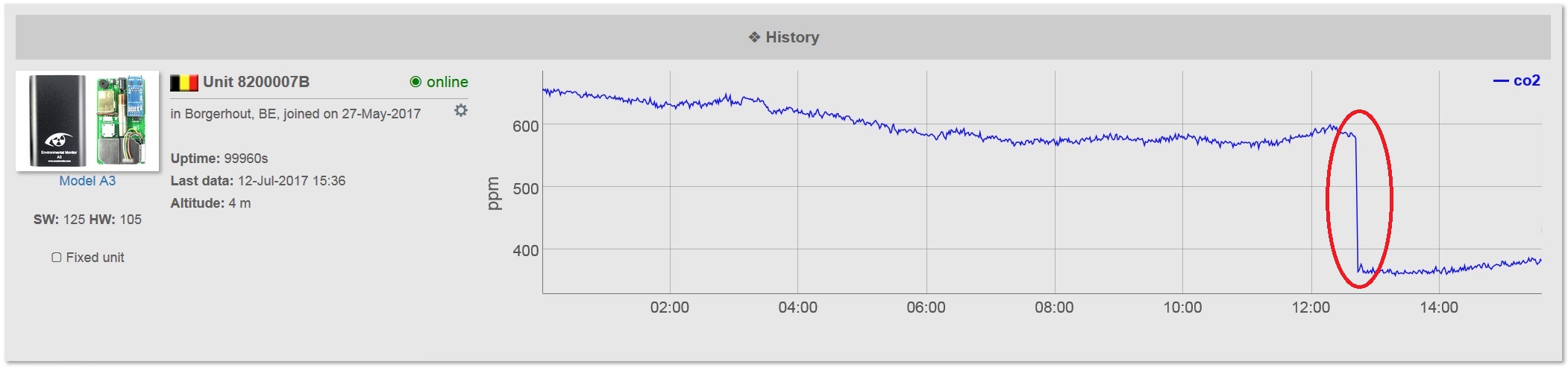

Participantis there something wrong with the co2 sensor,rather suddenly drop in levels ?
July 12, 2017 at 1:58 pm #4604SaltoUYStation
ModeratorThat straight-line drop reminds of when power is cut or systems are reset (rebooted). Was there a power interruption? That might explain the drop event – for the data change… re-analyzing after power cut? I don’t have a solid answer on that.
July 12, 2017 at 2:08 pm #4605ON1GL
Participantthanks for replying SaltoUYStation
there was no power loss, the unit is on a ups.
It happens about 24 hours after powerup, just read this pdf file
http://www.winsen-sensor.com/d/files/infrared-gas-sensor/mh-z19b-co2-ver1_0.pdf it could be autocallibration that kicked in (see page 9) ? but what are the correct values ?July 12, 2017 at 7:01 pm #4606uRADMonitor
KeymasterIt is possible this was the auto-calibration, which is enabled on these sensors by default. The power cycle, although possible as well is discarded because of the continuous data stream. After a power cycle, there should be no data for at least 3 minutes, which is the sensors warmup time on the A3.
