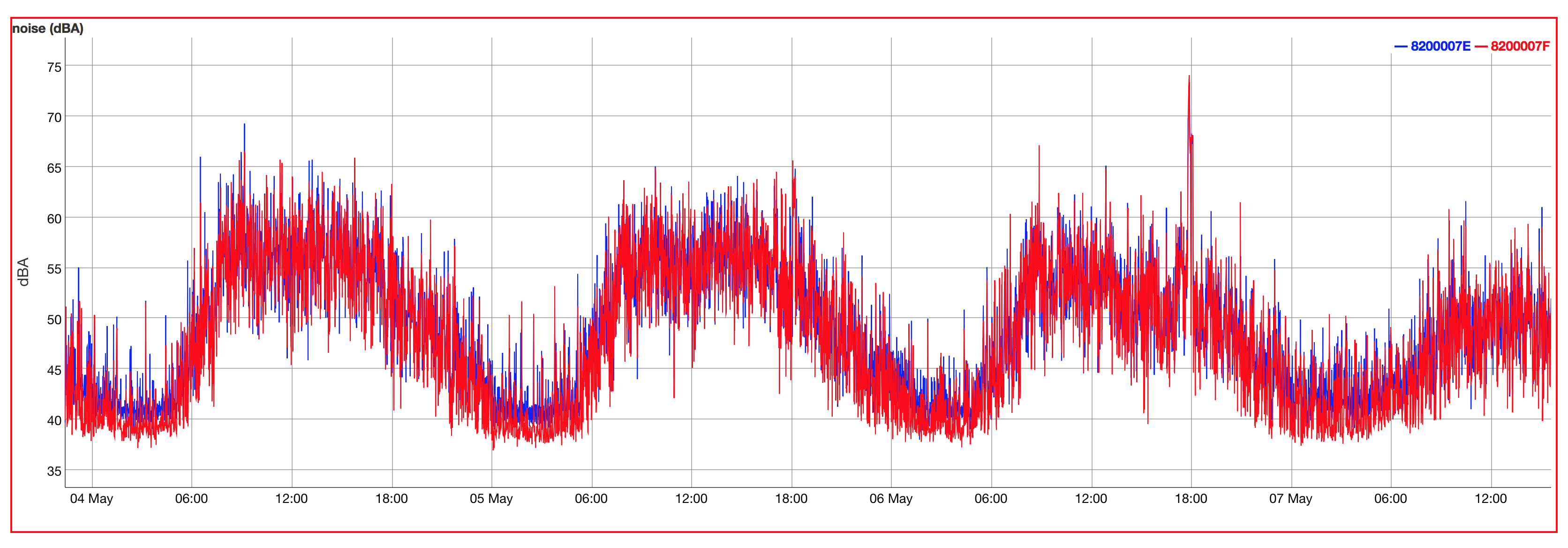

How did you got that nice noise graph Radu ?July 19, 2017 at 8:51 am #4640uRADMonitor
KeymasterThis one?
https://hackaday.io/project/12066-uradmonitor-a3/log/59583-hw105-succesThese were two units placed on the outdoors one next to the other, very close to a moderate traffic road. Daytime traffic became visible due to elevated noise levels.

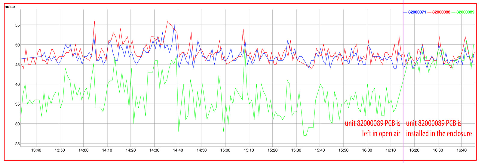

KeymasterThe noise sensor feature is currently experimental and got a bit too much exposure, also thanks to the forum community here (https://www.uradmonitor.com/topic/voice-sensor/). We got to roll it out a bit too soon, and there are major two issues:
1.Apparently, the issue is with the builtin fan, that creates too much noise in the same enclosure with the noise sensor. What happens is sounds below 45dBA cannot be detected.
2.Then the first boards was using an amplifier gain configuration of 100, a bit too much. This created some saturation, that we can see on the data from the various units.The fix for 2 involves only changing a resistor on the PCB (R28 from 100K to 39K) and updating the firmware. The fix for 1 doesn’t have a solution with the current design.
Attached please see noise-1.jpg illustrating the first issue. 82000071 and 82000088 are assembled and PCB is in the enclosure, while the 82000089 PCB is at first left unassembled.
Probably the best solution is to do the fix with the resistor+firmware, and install the microphone via a longer cable, away from the FAN.Attachments:

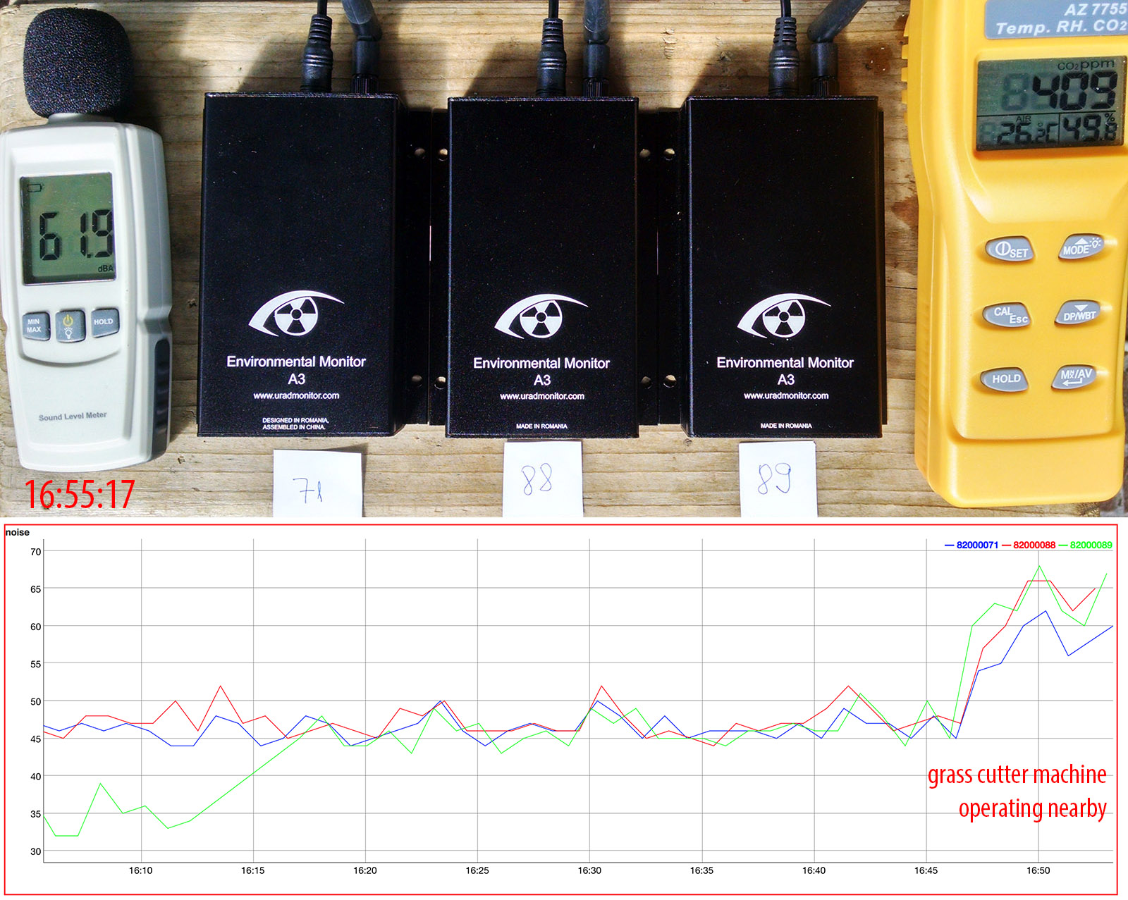

August 2, 2017 at 10:57 am #4704uRADMonitor
KeymasterIf the sound level of interest is above 45dBA, then all is good, here is an example with a grass cutter machine operating a few meters away from 3 test detectors.
