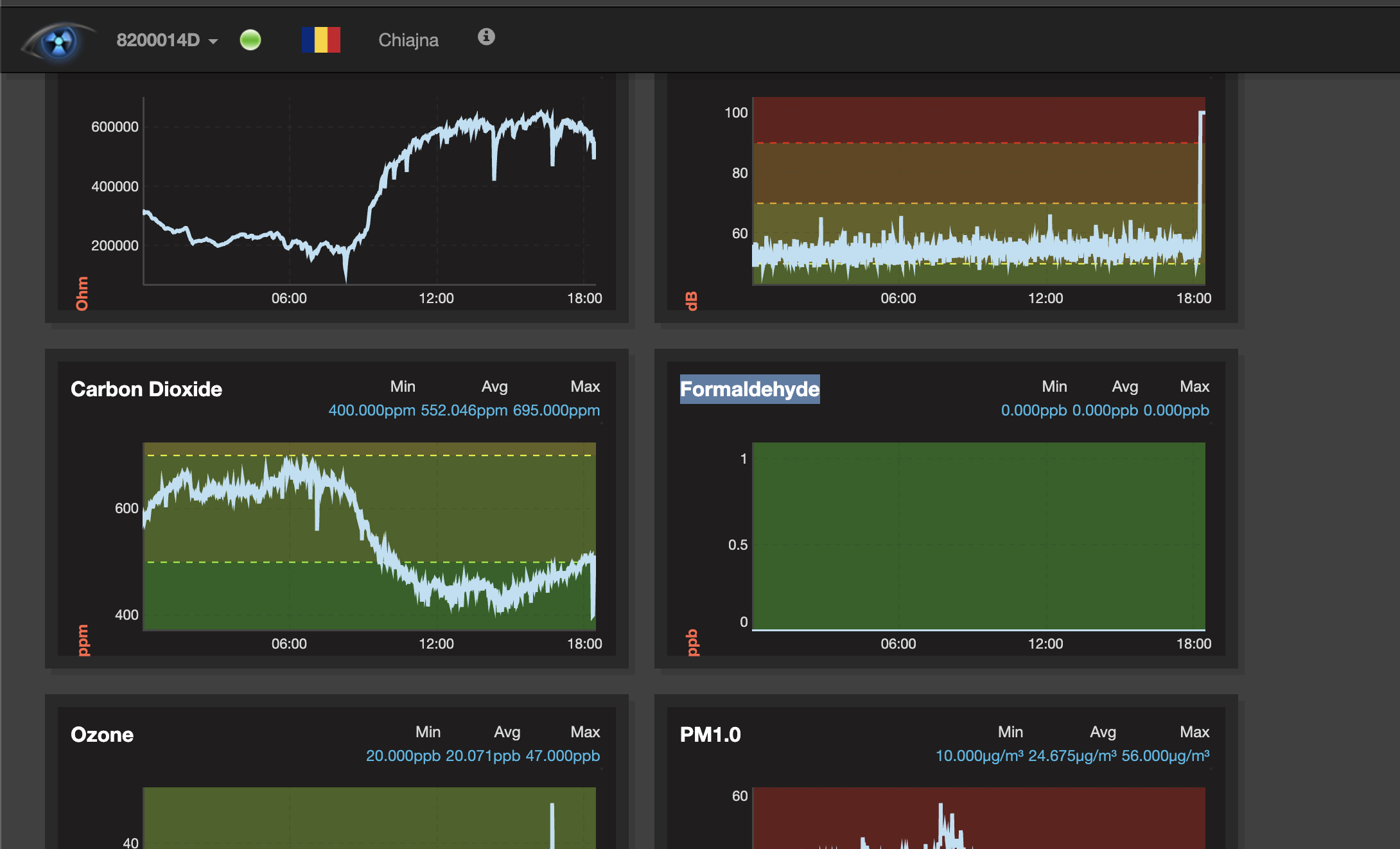

    Am instalat un A3 (8200014D) de foarte multi ani iar de curand a inceput sa dea o alarma pe care n-am mai auzit-o in toti acesti ani.
    Uitandu-ma pe Dashboard, am observat ca totul pare ok mai putin Formaldehyde care nu indica nimic. Se poate sa fie de la acest senzor, si daca da, ce e de facut?

    Electrochemical sensors have a lifespan of about 2 years, so that particular formaldehyde cell should be replaced. No, the alarm is not from that. A firmware update would help: https://www.uradmonitor.com/blog/?s=firmware
