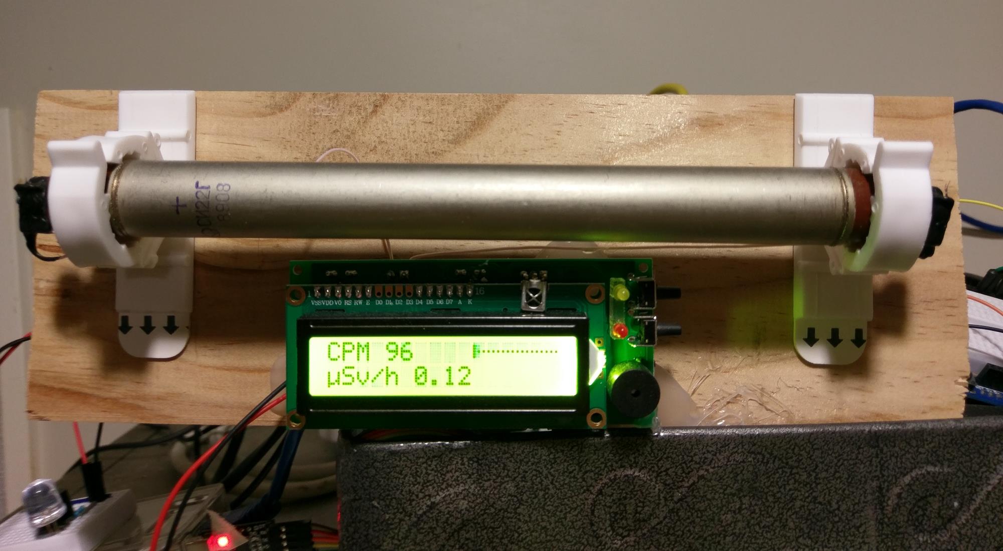

Here is my little DIY counter (attached).
Bought it from eBay.
