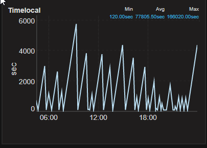

Ken JamrogowiczParticipantI would like to update this subject. After discarding the power supply and switching to POE, I got a nice run of some 46 hours – and then the A3 started re-booting again. However, this time it is distinctly different:
> the LAN activity does not stop (except for the 1 minute the reboot actually takes)
> the run times between reboots are random – see attachment (before it was like clockwork)This is not desirable, but it is an improvement – since, at most, one data point is lost.
