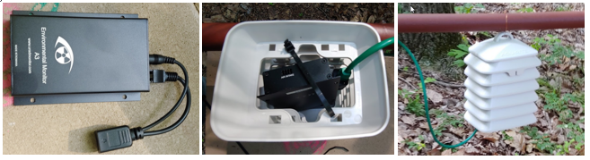

    I found a nice enclosure on Amazon
    The connecting cables poke through into the top of the enclosure and almost hold it in place, but I added a tie-wrap for security.
    The passive POE splitter is quite an inexpensive one. The only issue perhaps is that the A3 gets rather warm running on 24 volts.
    I guess it will help keep the snow off in the winter …
    #28436
    Looks great!
    24V is high, but the A3 supports it. I wouldn’t go higher than this for prolonged unit lifespan.
    #28439
    Ken Jamrogowicz
    Yes, it would be nice if the A3 had a switching power supply instead of just a 3-terminal regulator.
    I checked today and the voltage actually appearing at the unit is about 21 volts – so well within the spec.
    #28508
    The A3 has an internal switching DC-DC converter to drop the voltage down to 5V from whatever you feed it with in the interval 6V to 24V (it can go up to 28V but it is not safe).
