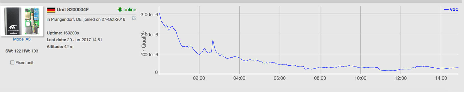

I can´t see a change.June 29, 2017 at 11:53 am #4574uRADMonitor
KeymasterI’m not sure, please see the picture attached:

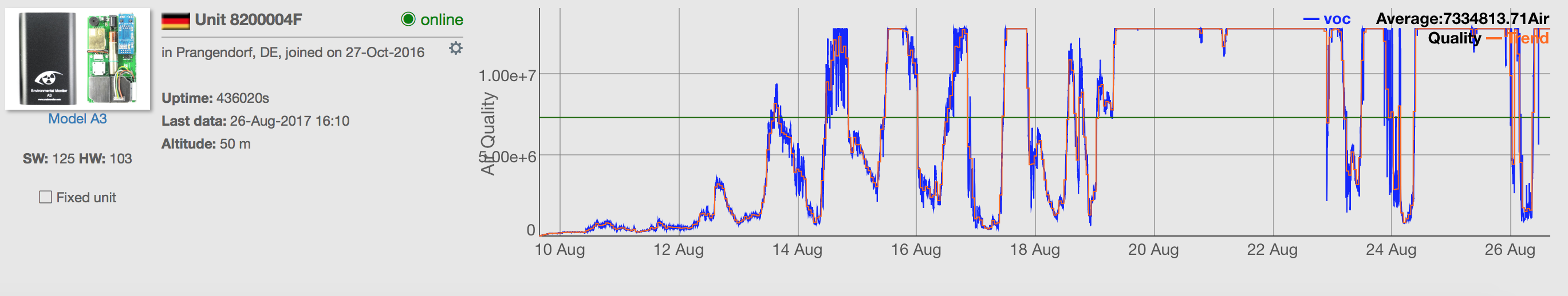

August 22, 2017 at 12:45 pm #4800JPRuehmann
ParticipantThe repair had not worked long.
Since three Days it is back flat at Top.
What now?August 26, 2017 at 1:14 pm #4802uRADMonitor
KeymasterHello JP,
I have attached a screenshot of the current data for the record.
The sensor was replaced since the last manifestation, so this is a new sensor showing the same behaviour.I will need some time to investigate this further. I might also need to discuss it with Bosch.
