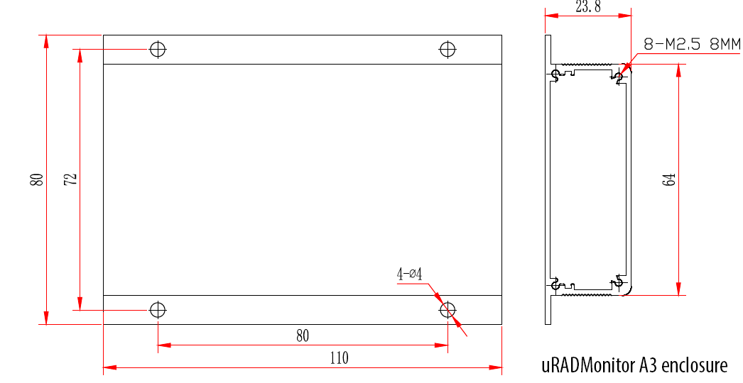

    From the datasheet the size is given to 110x65x25 mm (excl. sup).
    Anyone that have all the dimmensions for the Wi-Fi module?
    110x65x25 mm is for the box itself I believe, how big is the mounting wings, and if there is an external antenna, how long is this antenna?
    Have ordered this model and are trying to find/make an enclosure for it.
    Also, looks like there is no power supply provided with this, how much current does it draw?
    Thanks for the assistance.
    #4599
    Hi Terje,
    Please see the diagram attached for the A3 enclosure sizes.
    The unit comes with a 9V 1A adapter. The device, depending on connectivity model, uses about 1W, so at 9V the current is +/- 110mA.
    A3 can be powered with any voltage between 6V and 28V thanks to its internal high efficiency converter.
