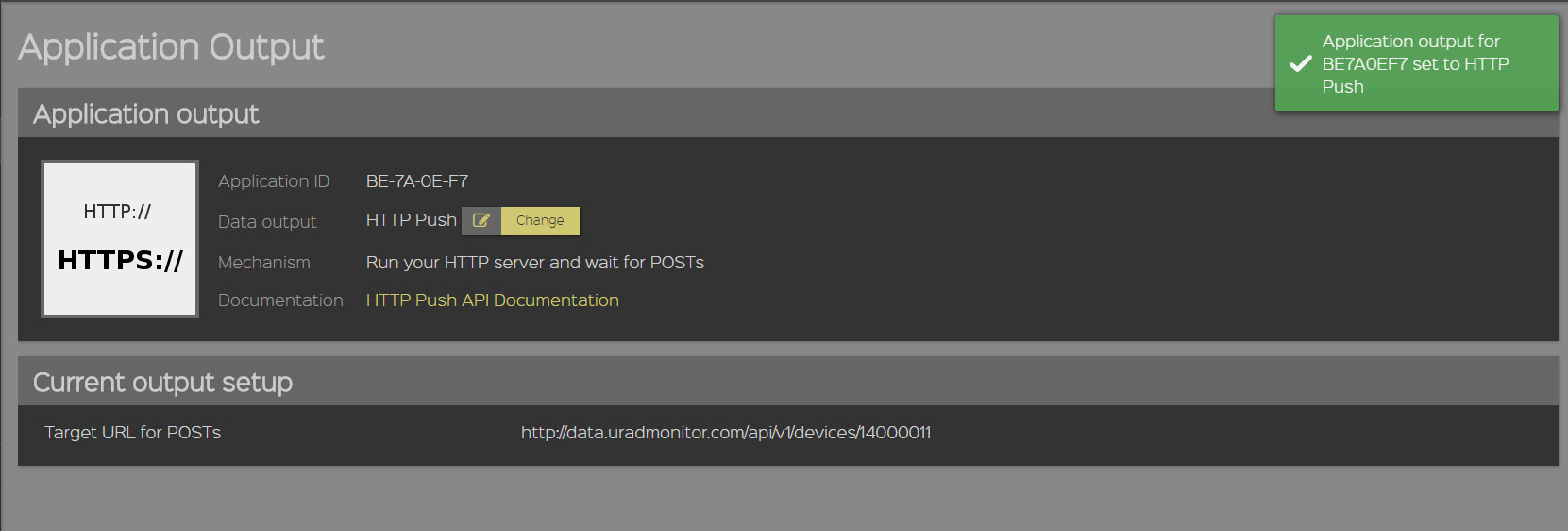

We are using Lora to communicate the uRADMonitor city.

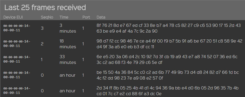

I am using Loriot network server, and the device is sending data to the loriot network server. And i have changed the Output to API on Loriot network server.

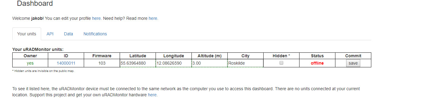

Still the device shows offline.
