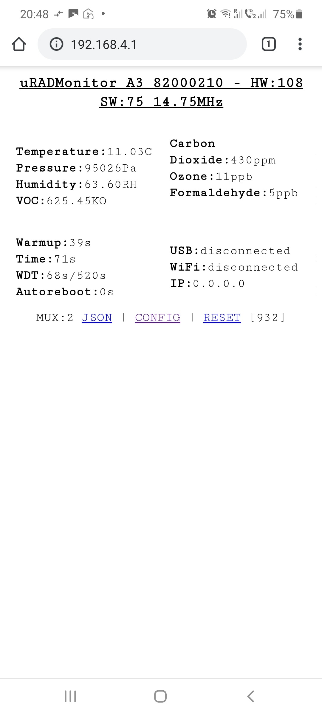

    My recently received unit disconects from wifi no matter that is placed near AP WIFI.
    I am not able to use such a unit can u fix the problem ? for example autoreconect or something..
    I need to turn power off and off to reconnect every few hours
    Thank you

    Unit: #82000210 model A3

    Schit Tarața
    Thank you for reply,
    I have tried several AP. I tried a separate wifi for this device..I just find it disconected and also the wifi configuration is lost. So there is a problem with this A3 but the company does not answer any of my emails.

    Schit Tarața
    For example today morning was offline. My network name was lost and I found that in config had the name of the network that was preconfigured
    How remembers that network but my network no ?

    I’m sorry that you’re experiencing problems.
    To me your description sounds like the power supply could be bad. The power supply delivered with your A3 should read 9 volts.
    Do you have any possibility to check that?
    You have mounted the antenna on your A3 correctly, right?
    If the issue still persists, you need to contact Radu directly.
    It could be that Romanian citizens are still in Corona virus lockdown and he can’t access his company emails.
    #28366
    Schit Tarața
    Seems that I was using a faulty power adapter. I have changed the power source and now seems to be stable.
