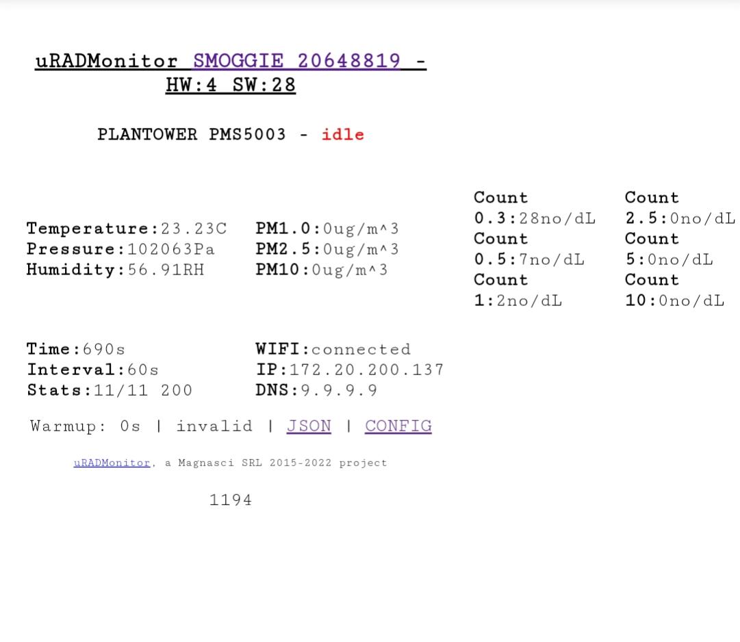

    My SMOGGIE-PM isn’t reporting any PM data. It appears to be rebooting every minute (I think)
    Once my SMOGGIE-PM is running, every minute the blue and green LEDs turn off, then the green LED flashes four times, then the blue LED comes on again. This happens every minute. When I look at the data, there is no PM data, though there is data for the other sensors.
    Attached is a screenshot from a local browser.
    Any thoughts? THanks!

    After I replaced the USB cable, the device stopped going through the apparent reboot every minute. Now the green status light stays lit and the blue light has a pattern of:
    ON
    40 seconds later: OFF
    20 seconds later: ON
    (repeat)
    I assume this is normal behavior.
    However, I am still not getting PM data. attached is a current screenshot

    Hi Newt, do you hear the fan when the unit is running? (Green Label on internal webpage, not the red “Idle” visible in your posts?)
    #29890
    newt
    Hi there! Yes, it’s running. It seems like it starts each minute and runs for about 20 seconds. Attached is a screenshot with the “Running” label.
    #29892
    Thanks. Please do a smoke test, burn a little piece of paper and right when the sensor goes into “Running” mode, Blow to extinguish the flame and send a little smoke towards the sensor. Do that for a few seconds . Take a new snapshot with what you see .
    #29893
    newt
    Well, I guess it is running. Lately the output is close to the output of another smoggie I have, so I guess all is good now. Attached is a snapshot of the smoke test. It was cool to do a smoke test that literally uses smoke!
    Thanks for our help in walking through this.
