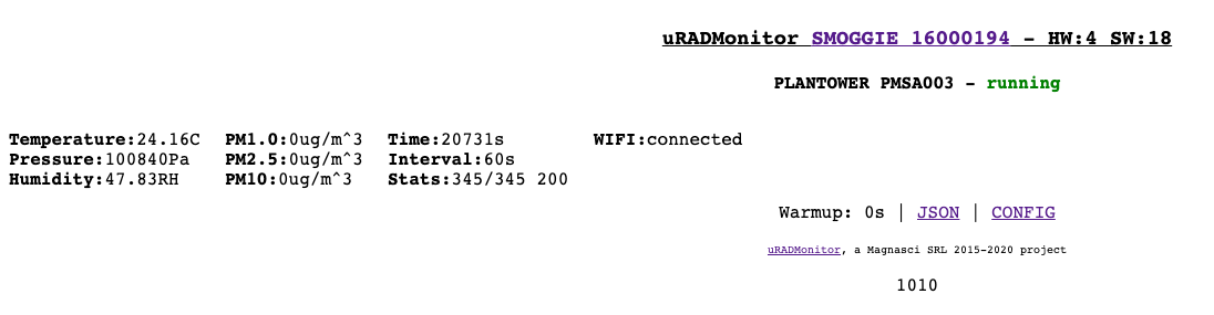

    I have a Smoggie PM which stopped showing any values a couple of hours ago. The little fan inside no longer spins.

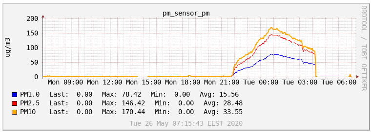

    All PM related values show only “0”. When looking at the graphs you can see a massive rise during the night and after that a fall to 0. I have attached the graph made locally using RRDTool. You can also see this on the data gathered in the cloud/api.

    It boots up. Actually, I can connect on the web interface and it also appears online in the uradmonitor dashboard.
    It just doesn’t display any values.

    Ah, sorry, I misunderstood. My Smoggie does also not always display values on its local webpage. You need to keep the webpage open and look (it updates itself frequently).
