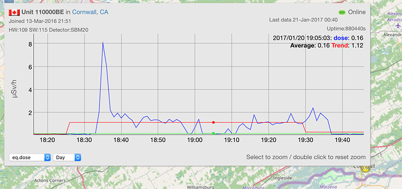

    WARREN BLAKE
    CHECK MY RADIATION LEVELS FOR TODAY JAN 20TH @ 11:30 – 12:45.!!! EST
    EXPLANATION: SOMEONE WAS HERE DURING THAT TIME WHO HAS A BONE SCAN AT 1400 HRS. SHE WAS INJECTED WITH SOME RADIO-ISOTOPE ABOUT 1030 HRS AND AS SOON AS SHE ARRIVED THE MONITOR WENT WILD!
    AS SOON AS SHE LEFT IT CAME BACK IN LINE!!
    AMAZING!!!! SHE WAS MOVING ABOUT IN THE HOUSE FOR THAT TIME AND FOR A 10 MIN. PERIOD AROUND 11:50 SHE WAS SITTING ABOUT 4M FROM THE MONITOR WHICH IS OUTSIDE THE WINDOW;
    ABSOLUTELY FASCINATING
    #4008
    For those that want to see it, here’s the unit link: https://www.uradmonitor.com/?open=110000BE
    And the phenomenon presented in the screenshot.

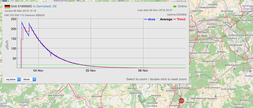

    #4011
    Indeed, this is the second time such an event is registered in the network, after the case of @em who himself has been administered radioactive Technetium for myocardial perfusion scans: https://www.uradmonitor.com/topic/5100000c-high-but-exponential-declining-readings/
