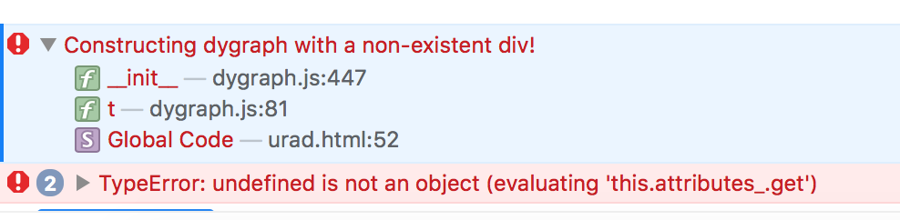

    #4756
    Hi Mads,
    You can use the “Inspect element” / “Inspect” to get info on what happens on various web pages. This shows there’s an error in the code, see the pic attached.
    Apparently, you called the Javascript that does download and chart BEFORE the html code initialised the code for the chart DIV. Please do the javascript after.
    Let me know if this helps,
    #4817
    Mads Barnkob
    You are absolutely right!
    I just stopped thinking and put all the javascript in the top 😮
