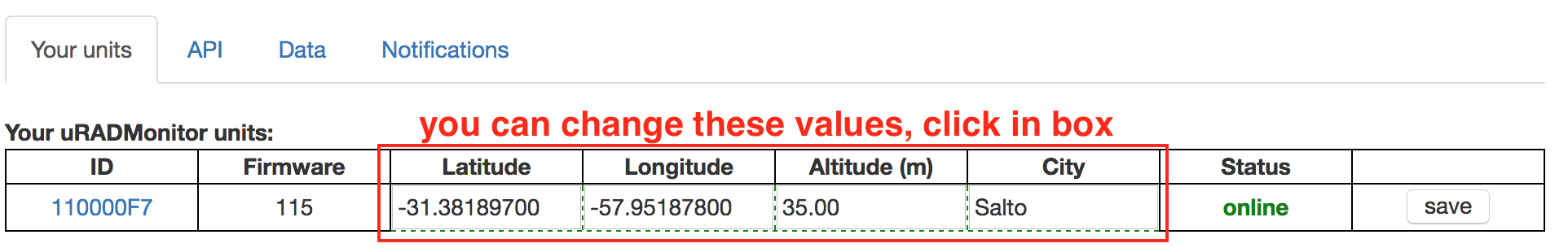

    Hi skyline-stu – I couldn’t figure out how to place my unit on the map either – Radu explained that the values in the dashboard can be changed. You can get your longitude /latitude here: http://www.latlong.net/ (if you don’t already have it, then input).
