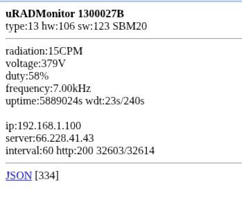

Hello,
51000076 and 1300027B. In dashboard both are offline, but they are connected to internet correctly.
Please include some snapshots with the two devices, from their internal webpage.
Hello,
my mistake, problem was solved with correct user-key in dashboard.
