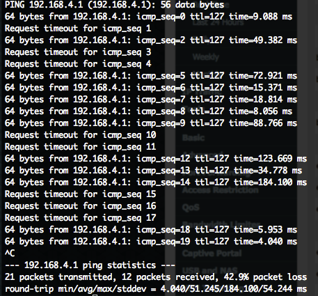

    The device spawns a hotspot as expected, I’m able to connect to it, get a 192.168.4.2 IP address, see the configuration and get it to connect to my local wifi connection,
    It then gets a local IP address but it’s almost impossible to have a reponse from either IP sides (local/hotspot), I have a lot of lost packets (see attached).

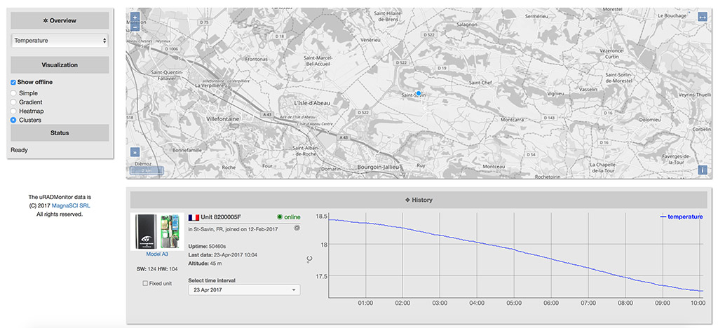

    I see the data looks ok: https://www.uradmonitor.com/?open=8200005F
    Is the signal between your unit and the wlan router ok?

    If you feel something is not right, you can send it back for verifications, however I see it is up and running as we speak, with a consistent (big) uptime of 50460seconds: https://www.uradmonitor.com/?open=8200005F
    The unit itself seems to be functioning normally, but if signal is an issue, I do recommend placing it closer to the router, or simply using a bigger antenna.
