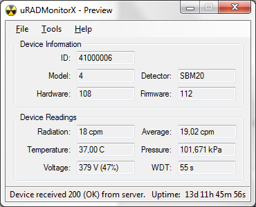

ModeratorI’ve made a little application to display in a more friendly manner the readings from my uRADMonitor device. It just sits in system tray and polls the device periodically via HTTP.
It works only under Windows and requires .NET Framework 2.0.
The latest version
is 0.33.0 is and itcan be downloaded fromhereGitHub release page.The configuration is pretty straight forward. From Tools menu -> Device configuration -> fill your device IP Address -> click Save.
I hope you’ll find it useful.

July 4, 2015 at 4:28 am #2020Steve
ParticipantThat’s pretty cool. Thanks for sharing it.

July 7, 2015 at 8:08 pm #2048cristianst85 (nox)
ModeratorHi guys, thanks for feedback.
@Rob, of course. An auto-scan feature can be a nice addition especially for non-tech people. As I said I’ll release the source code soon.
@David, I’ve already had in mind adding some notifications to system tray (e.g. application cannot connect to the device, device got an error when sending data to the server – server return code is not 200). I am adding those you mentioned to the todo list.About the other thing, now it only supports strict IPv4 addresses, but I think I can change the validation to accept something like {ip_address}:{port} if that helps you.
