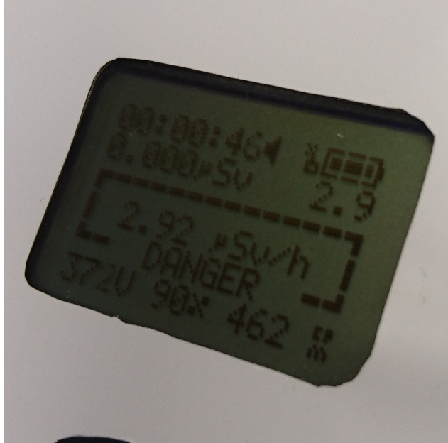

    We pointed the x-ray head directly at the dosimeter, just like if a picture was taken of a persons mouth.
    The unit was set up for 160 ms ontime at 65 kV, 7.5 mA. This resulted in a alarm from the dosimeter, showing 462 CPM and 2.92 uSv/h when we got back in the room, so it properly fell a little from shot to entering again, some 3-4 seconds.
    The total dose was not yet calculated here, but half a minute later it showed 0.038 uSv, the unit had been turned on for about 1+ minute at that time.

    nice experiment!
    160ms 65KV 7.5mA resulting in an accumulated total dose of 0.038uSv? What was the distance from the head to the detector?

    Those are the numbers I recorded.
    About 1-2 cm, pointed as good as possible to the center of the GM tube.
