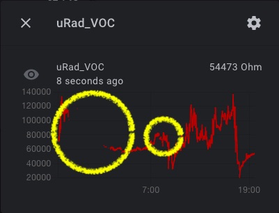

    Does anyone have experience with integrating A3 sensor values into Home Assistant?
    I have created a number of sensors in configuration.yaml, something like this one:
    - platform: rest
        resource: "http://192.168.11.122/j"
        value_template: '{{ value_json.data.voc }}'
        unit_of_measurement: "Ohm"
    Unfortunately the values I get are totally inconsistent and all the historical graphs are looking like this:
