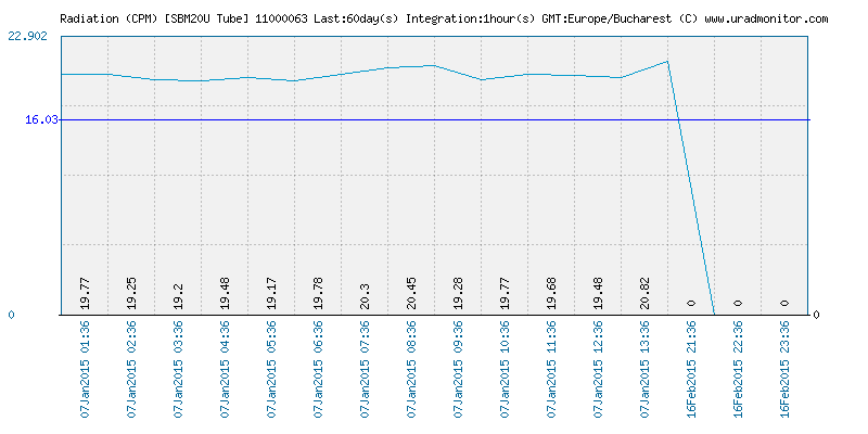

    This can only indicate tube damage during transit, but it is somewhat unlikely, as it never happened until now. Unit data during pre-shipment tests is attached.
