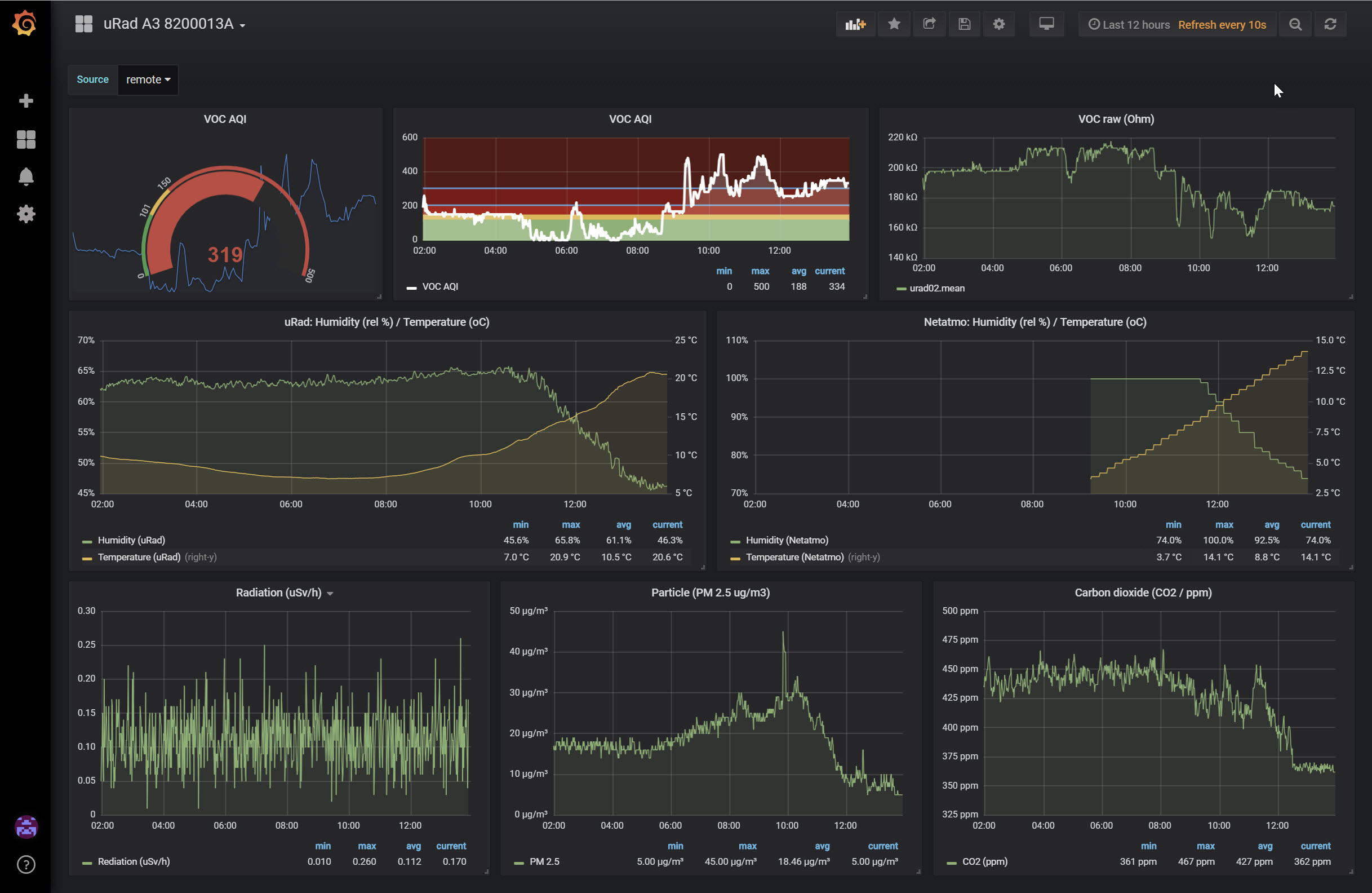

    Maybe some of you are interested: how to collect the uRad A3 data, store them in a time series database and monitor the metrics.
    The components to use are:
    – NodeRed to wire up the REST API of uRad with the database
    – InfluxDB to store and retrieve the data with high performance
    – Grafana to present the data in nice graphics and monitor with anomaly detection
    In the end, it looks something like the screenshot I’ve added to this post.
    If you’re interested, give me a call.

    We are doing the same also for our community network in Syros, Greece and also professionally for others.
    The pic is from our community monitoring server. We also use Chronograf and Kapacitor for realtime alerts to a Telegram announcement channel. I was supposed to write a small blog post with basic instructions but haven’t found the time to do it (my fault)…
