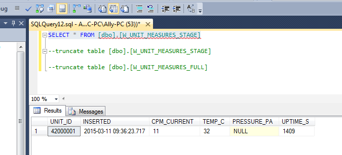

What I’ve done is created an ETL task which parses a string/JSON into a table (see screenshots attached). I can parse a string from the Unit /j page no problem, in the format;
string wUrl = "{\"data\":{ \"id\":\"42000001\",\"type\":\"4\",\"detector\":\"SI29BG\",\"cpm\":11,\"temperature\":32.00,\"uptime\": 1409}}";But when I try to parse using the URL;
string wUrl = "http://10.0.0.81/j.json";I get no outputs from my Script. Any ideas what I’m missing?
