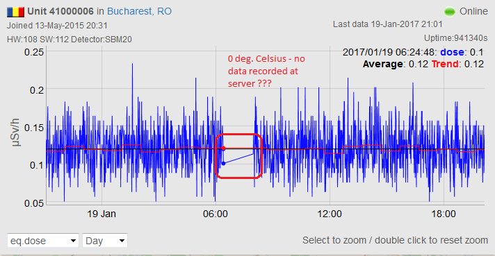

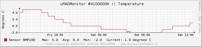

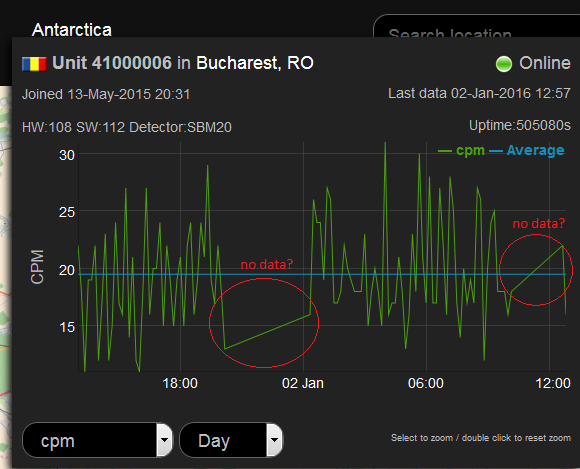

    I’ve noticed that no data is available (maybe not even recorded into database?) from my unit (41000006) for all data sets (cpm, temperature, etc) when measured temperature is 0 degrees Celsius.
    For example between
    1451671853 (01/01/2016 @ 6:10pm UTC) and 1451686845 (01/01/2016 @ 10:20pm UTC) there is no data.
    Also between
    1451722226 (01/02/2016 @ 8:10am UTC) and 1451731221 (01/02/2016 @ 10:40am UTC) there is no data.
    Note: The timestamps in ‘41000006-data-recorded-with-uRADMonitorX.zip’ file are in local time (UTC+2).

    Had another look on this, and a cause of this problem was still not evident. What we know so far:
    – the device functions uninterrupted, as presented by the uptime field
    – the device returns all temperature values, including 0, as shown in the logs
    – the server returns the data packets, as shown by the successful HTTP return code, 200
    This apparently points to an error in the server script decoding and handling incoming data. Some changes where implemented which could be related to the issue, but let’s keep an eye on it.

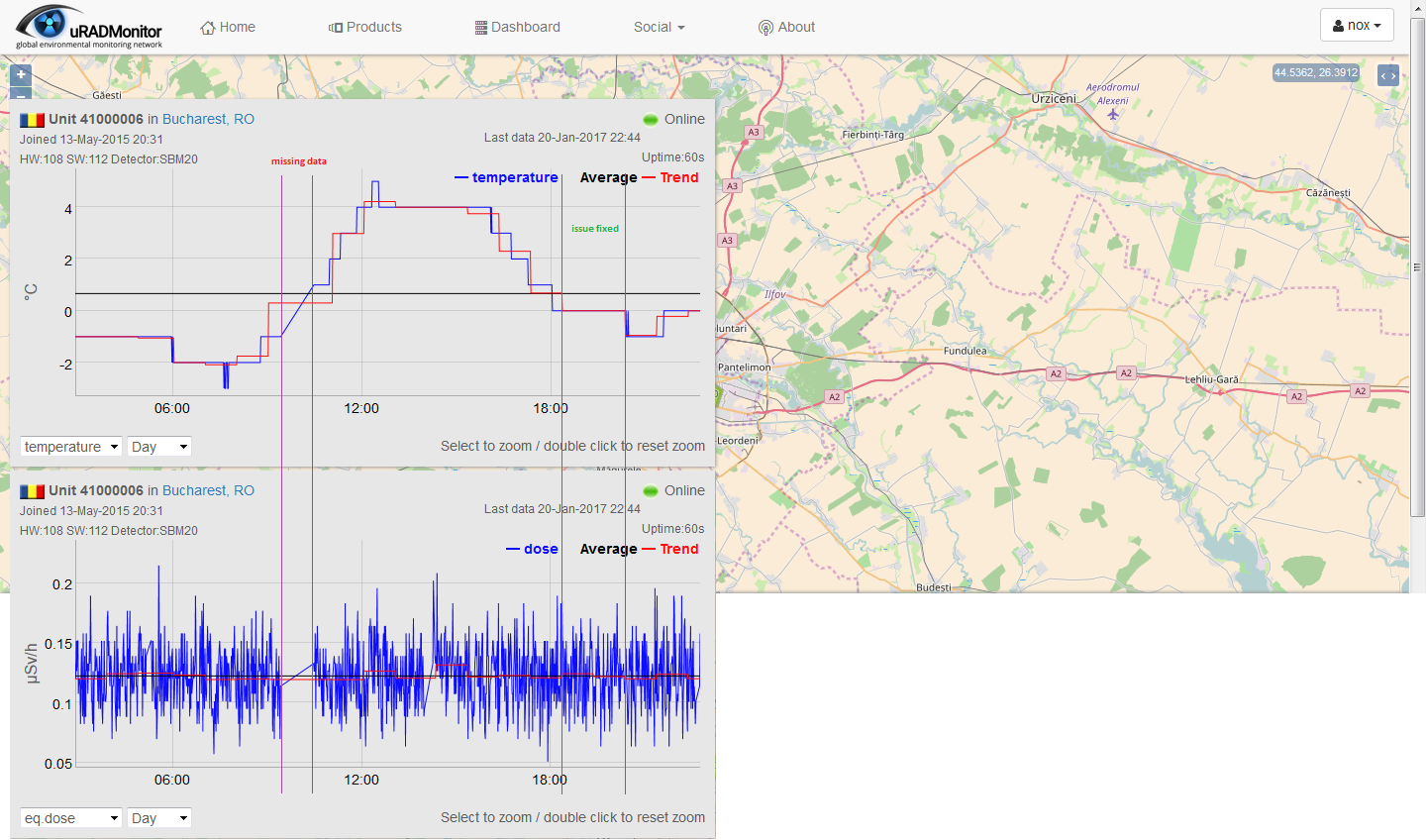

    #4004
    Problem found and fixed.
    #4006
    That’s excellent.
    I can confirm that the issues was fixed.
    Thank you!
