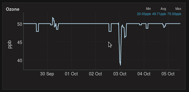

    Stratos Zolotas
    What about the ozone, I’m on HW:106 SW:137 and I don’t get why ozone is mostly stuck on 50ppb, with only some down spikes and some very limited up spikes. Check the attached image. Sensor is 8200015E.
