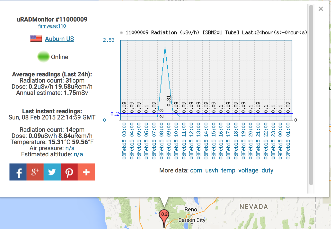

    I’ve noticed when I power-up the uRad, the first reading is abnormally high. Yesterday we had a storm pass through and caused a power failure. Attached is the graph from the uRad site on 8Feb 09:00 that there is a reading spike. This was when the power came back on.
    You might want to ignore readings unless the unit uptime shows it has been up for awhile so as not to record incorrect readings — the 10:00 entry is correct.

    I didn’t notice this in my tests so it might be a particular case. Ignoring the first readings is not the best option, we would need to see the root cause of the spike instead. Ignoring would waste precious data, and we’ll never know how to set a “first interval” value. 1 minute? 10minute? Not reliable as if there is a problem it can happen at any time.
    Looking at the chart I see the time axis is continuous, where did the power off occur?
    On older firmwares there was a default duty cycle set for the inverter. At power up this could have produced higher voltages, potentially resulting in excessive counts on the geiger tube, however I see you run 110 already, where the duty cycle starts at an absolute minimum and is brought up to the required value, as controlled by the internal regulator.
    Another cause might be the so-called “compensation capacitor” that might need to be replaced on your unit. This component is responsible for controlling any unwanted oscillations taking place over the tube. But I see no reason why this capacitor would fail, so this is not a real explanation either.
    Power failures might still induce voltage spikes of various kinds. Can you run a few power off/on cycles and see if this is happening on a consistent basis? I suspect not.
