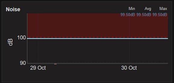

    Set up the device a couple days ago and everything seems to be working except the noise monitor. Any suggestions on next steps ?
    See here or attached screenshot.

    Your unit shows a constant noise level of almost 100 dB, that is very loud. You’ll probably need to contact Radu to find out whats going on with the unit.

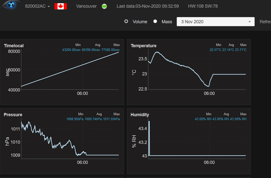

    Yes, I agree, 99db would be very loud in reality so seems something is wrong with the noise sensor. I’ve also noticed another issue – it seems the Pressure, Humidity and Temperature sensors also seem to flatline regularly after some time being online. See today for example, a few minutes after 6AM.

    Hi Jank,
    Can you test another power supply? There were several case reports with all sorts of weird behaviour of units because of bad power supplies.
